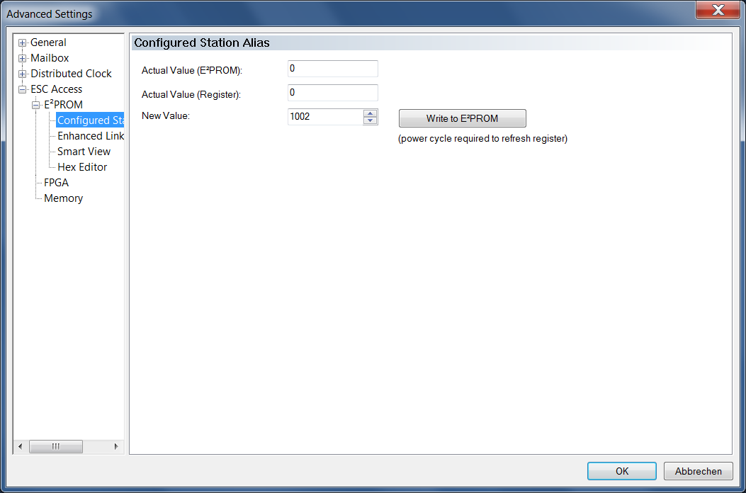

ESC Access EEPROM Configured Station Alias
Actual Value (EEPROM):
The "Actual Value (EEPROM)" text box shows the current address value in the EEPROM.
Actual Value (Register):
The "Actual Value (Register)" text box shows the current address value in the register. The address value in the register is only updated after a restart.
New Value:
The "New Value" NumericUpDown control can be used to set a new address value for the slave device. This functionality is useful for devices in a Hot Connect group.
Write to the EEPROM....:
The newly set address value can be written to the EEPROM with the "Write to EEPROM…" button.
