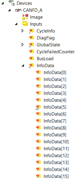

InfoData
The following data can be read from the info data of the FC532x / CX-M530:
InfoData 1:
Fig.15: InfoData
