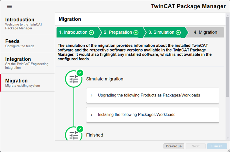

The first step is to download the migration tool from the feeds. This then carries out a simulation in the next step. This checks which TwinCAT functions are installed on your system and the corresponding workloads with associated packages are searched for and listed in the TwinCAT Package Manager.
Migrate existing TwinCAT software 2:
7. Confirm the simulation with Next so that the old setups are uninstalled and the new workloads are installed instead.
