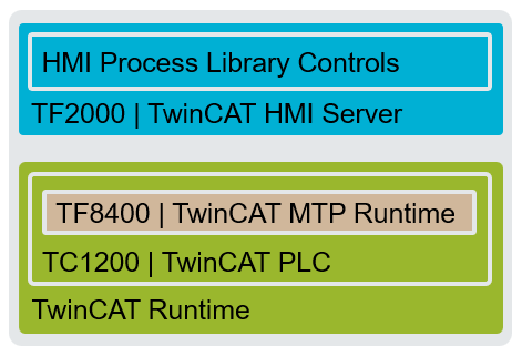

With TwinCAT PLC MTP Library
The HMI Process Library provides controls compatible with TF8400 | TwinCAT MTP Runtime FBs that conform to the MTP Specification. This allows the control to be mapped to just one PLC symbol.
System architectures 1:
This architecture implies that PLC can also be controlled by POL/DCS.

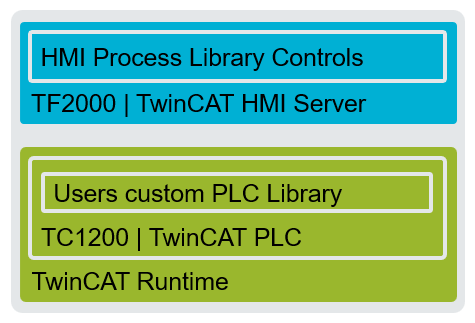

Without TwinCAT PLC MTP Library
Using the HMI Process Library without the PLC MTP Library gives the user the option to utilize ready-to-use controls with the user’s own FBs for standard and non-standard technological equipment.
System architectures 2:
