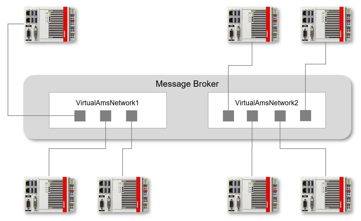

Virtual networks
When configuring ADS-over-MQTT, so-called "virtual networks" can be defined. This allows ADS devices to be distributed into independent networks. Only the devices within a network can communicate with each other. At MQTT level, this distribution takes place on the basis of a common basic topic.
Virtual networks 1:
These virtual networks can be defined at client level using the ADS-over-MQTT configuration file and, if required, access rights can be assigned using the TcMqttPlugin for the Mosquitto Message Broker.
