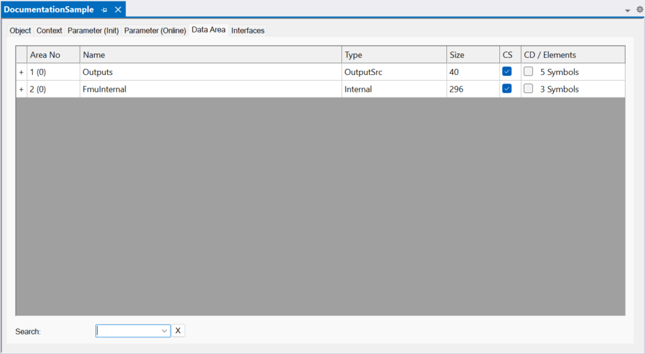

Data Area tab
Data Area tab 1:
Area No
ID of the data area
Name of the data area
Type
Type of the data area or variable
Size
Size of the data area or variable
CS
Option to create the ADS symbols for the data area
CD / Elements
Option to create the data types on the runtime system so that they are available for the symbols.
