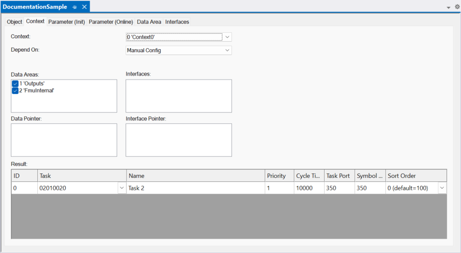

Context tab
Context | Choice of context for the settings to be changed (using the ID from the table below). |
Depend On | Setting how this context is called up. (Manual setting, based on the parent object, based on the data areas, based on the task settings) |
Data Areas | Choice of which data area is to be updated from the selected context. |
ID | ID of the context |
Task | ID of the tasks assigned to the context |
Name | Name of the assigned tasks |
Priority | Priority of the assigned tasks |
Cycle Time | Cycle time of the assigned tasks |
Task Port | Tasks port of the assigned tasks |
Symbol Port | ADS symbol port of the selected tasks |
Sort Order | Sort order with which the module logs on to the task. (The smaller the number, the more likely it is to be called up in the list of registered modules.) |
