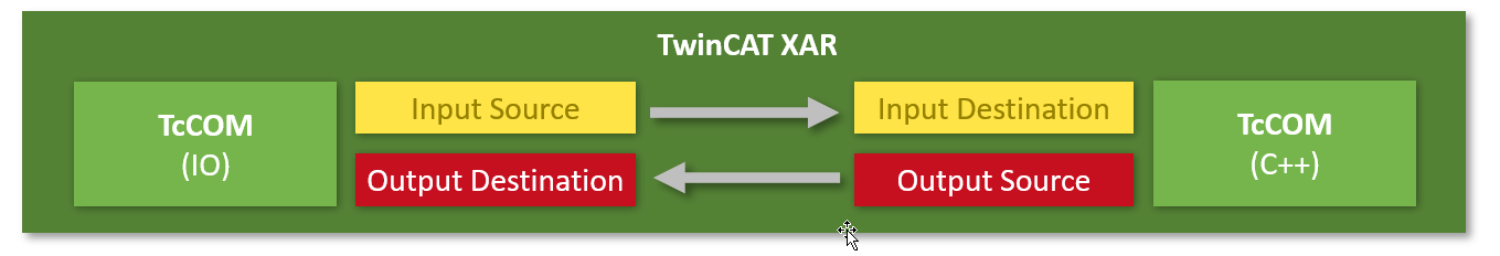

Type: Defines the purpose and location of the data area.
The data areas for mapping (to other modules as well as I/O) are classified into input and output as well as source and destination. The chart illustrates this:
