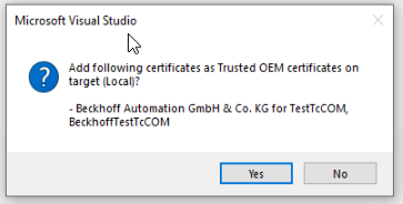

Execution of the sample project
1. Select the target system and compile the project.
2. Enable the TwinCAT configuration and execute a log-in as well as starting the PLC.
In the online view of the PLC application the desired TcCOM object name in the PLC Proxy function block can be seen. The project node TcCOM objects keeps the generated object with the generated ID and the desired name in his list. The interface pointer has a valid value and the method will be executed.
Execution of the sample project 1:
