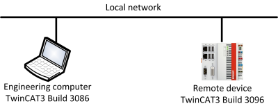

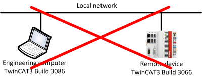

The TwinCAT Automation Interface is installed automatically during TwinCAT setup. Consequently, the same hardware and software requirements apply as for TwinCAT System Manager / TwinCAT 3 XAE (Engineering). When using the Automation Interface to configure a remote TwinCAT participant (XAR), the remote version of TwinCAT should generally be the same as the version on the development computer. The Automation Interface also provides access to the TwinCAT Remote Manager, allowing you to load a specific version of the TwinCAT project if a lower version is being used on the target system.
