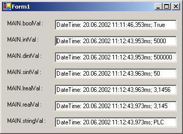

There are 7 global variables in the PLC. Each of these PLC variables is of a different data type. The values of the variables should be read in the most effective manner, and the value with its timestamp is to be displayed on a form.
In the form's load event, a connection to each of the PLC variables is created with the TcAdsClient.AddDeviceNotification() method. The handle for this connection is stored in a array.
The parameter TransMode specifies the type of data exchange. AdsTransMode.OnChange has been selected here. This means that the value of the PLC variable is only transmitted if its value within the PLC has changed (see the AdsTransMode data type). The parameter cycleTime indicates that the PLC is to check whether the corresponding variable has changed every 100 ms. MaxDelay allows to collect notification for a specified interval. If the maxDelay elapse, all notifications will be send at once.
When the PLC variable changes, the TcAdsClient.AdsNotification() event is called. The parameter e of the event handling method is of the type AdsNotificationEventArgs and contains the time stamp, the handle, the value and the control in which the value is to be displayed. The connections are released again in the closing event by means of the TcAdsClient.DeleteDeviceNotification() method. It is essential that you do this, since every connection established by TcAdsClient.AddDeviceNotification() uses resources.
You should also choose appropriate values for the cycle time, since too many write / read operations load the system so heavily that the user interface becomes much slower.
Advice: Don't use time intensive executions in callbacks (OnNotification()).
