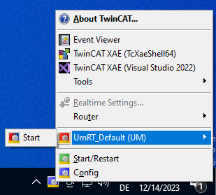

Starting the TwinCAT 3 Usermode Runtime
The TwinCAT 3 Usermode Runtime can be started via the TcSysUI:
Starting the TwinCAT 3 Usermode Runtime 1:
The TwinCAT 3 Usermode Runtime starts in the background.
The router status can then be queried and changed via the same menu.
A minimized window provides additional interaction:
