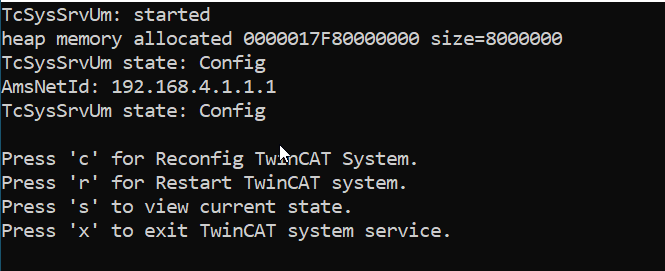

If the TwinCAT 3 Usermode Runtime is started on the command line, the following output appears:
- "c" switches to Config mode
- "r" switches to Run mode
- "s" queries the current state
- "x" exits the TwinCAT 3 Usermode Runtime
