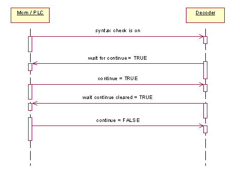

Display
Parameter | Description |
X_SyntaxCheck | Display: syntax check active |
X_WaitAfterError | Display: decoder waiting for enabling to continue |
X_SyntaxCheckWaitContinueCleared | Display: decoder waiting for cancellation of enabling to continue |
Syntax check active | |
Description | Decoder is currently in the syntax check |
Signal flow | CNC→PLC |
ST path | pMC[channel_idx]^.addr^.StateDecoder_Data.X_SyntaxCheck |
Data type | BOOL |
Value range | [TRUE = decoder operating in the syntax check, FALSE] |
Access | PLC reads |
Peculiarities | - |
Error has occurred during syntax check waiting for external input | |
Description | In the syntax check mode, the decoder waits after an error for an external input (continue, abort) |
ST path | pMC[channel_idx]^.addr^.StateDecoder_Data.X_WaitAfterError |
Data type | BOOL |
Value range | [TRUE = error has occurred in the syntax check decoder waits, FALSE] |
Peculiarities | - |
Description | Decoder is currently operating in the syntax check and, after an error and enabling, waits until enabling is cancelled again. |
ST path | pMC[channel_idx]^.addr^.StateDecoder_Data.X_SyntaxCheckReleaseNextBlockCleared |
Data type | BOOL |
Value range | [TRUE = Decoder waits for deletion of enabling, FALSE] |
Peculiarities | - |
Decoding interrupted | |
Description | Decoding has been interrupted and waits for enabling to continue. |
ST path | pMC[channel_idx]^.addr^.StateDecoder_Data.X_WaitContinue |
Data type | BOOL |
Value range | [TRUE = decoder interrupted, FALSE] |
Peculiarities | - |
Description | Decoding has been interrupted and the decoder waits until enabling is cancelled again before resuming. |
ST path | pMC[channel_idx]^.addr^.StateDecoder_Data.X_WaitReleaseNextBlockCleared |
Data type | BOOL |
Value range | [TRUE = decoder waits, FALSE] |
Peculiarities | - |
