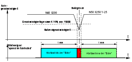

The IPO status signal speed limit detect is generated depending on the set parameters if the programmed contour leads to deceleration along the path with the speed dropping below the speed limit, e.g. due to a corner.

The parameters listed above and the F word in the NC program result in:
Speed limit = 75% of the programmed feed
-> v_limit = 3750mm/min (62500um/s)
In the program example, the path feedrate drops due to a contour knee angle of 30 degrees to 8562um/s at the N40 -> N50 block transition, i.e. the speed limit detected status signal is set at a distance of 1mm before falling short of the speed limit at the block end N40 and 1mm after exceeding of the speed limit at the block start N50.
