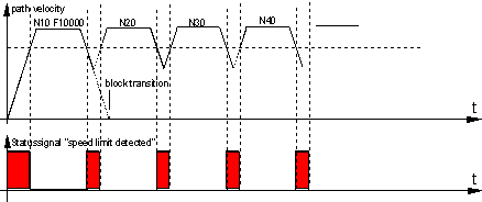

Description 1:
Figure 1-1: F word and "speed limit detected" status signal
Influence of override
The influencing of the speed limit via the real time feed override can be controlled by the parameter P-CHAN-00155.
In default case the real time feed override does not influence the speed limit value P-CHAN-00089.The „speed limit detect“ status signal is also set if the path feed rate weighted with the override drops below the speed limit P-CHAN-00089.
Because the override is an online-influence by the user/application the in advance setting or delayed clearing is not considered in this case.

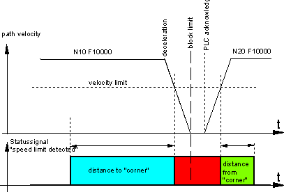

Description 2:
Figure 1-2:Timing diagram without override weighting (f_override_weight_v_limit = 0)
If the parameter P-CHAN-00155 is set on 1, the parametrized speed limit value P-CHAN-00089 is weighted by the override value. This is desirable e.g. for the commissioning or the running in of contours. It must be taken into account for non-constant programmed feed, that the SLD signal is getting active each in acceleration phases, because at block beginning the speed limit is set on the new value.

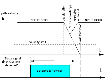

Description 3:
Figure 1-3:Timing diagram with override weighting (f_override_weight_v_limit = 1)

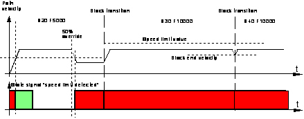

Waiting for PLC-acknowledge
Description 4:
Figure 1-4: Missing PLC acknowledgement and "speed limit detected" status signal
In the case of M functions of the MVS_SNS type, later synchronization, or M functions with look ahead, the CNC stops only if the PLC acknowledgement is missing. Restarting is possible again if the PLC's acknowledgement signal arrives before motion stopping.

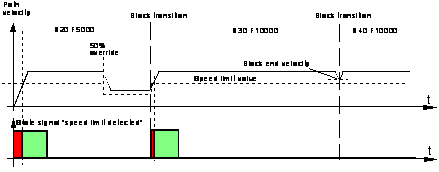

PLC-acknowledge during deceleration
Description 5:
Figure 1- 5 : Restarting after PLC acknowledgement resets the „speed limit detect“ status signal.
