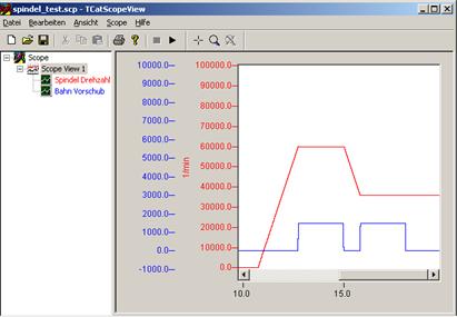

Example 2: spindle synchronous with contouring motion
spindel[i].s_synch    0x00000002  Output before, sync. before block
spindel[i].m3_synch   0x00000001 No sync.
N10 M3
N20 X40 Y40 G1 F1500 S500 Contouring motion does not start until spindle speed reached.
N30 S100 X0 Y0 Contouring motion is interrupted to reduce spindle speed.
