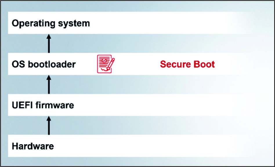

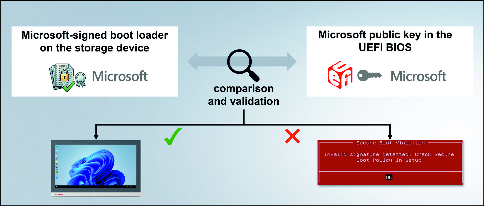

Secure Boot uses certificates stored in the UEFI firmware, for example from Microsoft, to check the digital signatures of boot components at system startup. This ensures that only unmodified software signed by trusted publishers is loaded. They are necessary to prevent manipulation or the loading of unsafe software. The process is shown in simplified form in the following illustrations.
Technical basics 1:Fig.1: Simplified boot process with Secure Boot
Technical basics 2:Fig.2: Key synchronization during secure boot process

The expiry of certificates can cause problems when starting devices if these certificates are not updated in good time. If old keys are then saved in the UEFI firmware, but the bootloader has been signed with a new certificate, Windows will no longer boot. Microsoft has been providing new certificates since 2023, which must be installed to ensure continued secure operation.
