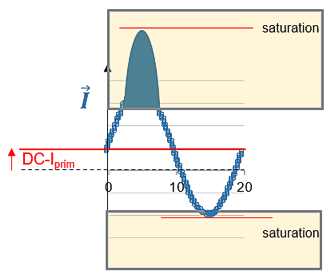

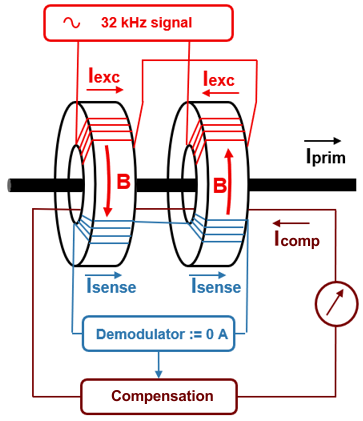

Fig.4: Principle fluxgate current measurement technologyThe measuring principle of the SCT5xxx is based on a differential current measurement of two oppositely excited cores in the transformer. For this purpose, both cores are brought into saturation with an excitation winding (red) with an internally generated 32 kHz signal, whereby the first core is driven in the positive and the second in the negative range of the y-axis. See fig.)
Fig.5: Characteristics fluxgate current measurement technologyThe detection winding now measures the induced current of the excitation winding (blue).
If the measuring current Iprim = 0, then 0 A is also measured, as no compensating current is generated for compensation.
If the exhibition current Iprim is not equal to 0, a compensating current is generated through both cores, which compensates for the imbalance of the magnetic flux density B in core 1 and core 2. Due to the compensation, Isense is 0 again.
The measured compensating current provides information about the current to be measured Iprim.
Together with a fixed excitation frequency, this leads to improved accuracy and stability.
