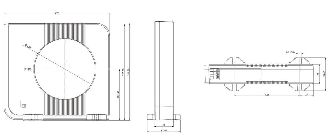

SCT4416-0025 dimensions, size 4
SCT4416-0025 | Ring-type CT, differential current type A, 25 A AC, size 4 1:Fig.20: SCT4416-0025 dimensions, all dimensions in mm
