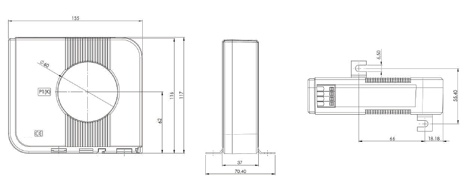

SCT4316-0025 dimensions, size 3
Fig.19: SCT4316-0025 dimensions, all dimensions in mm
