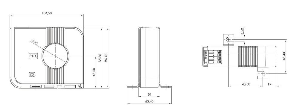

SCT4216-0025 dimensions, size 2
SCT4216-0025 | Ring-type CT, differential current type A, 25 A AC, size 2 1:Fig.18: SCT4216-0025 dimensions, all dimensions in mm
