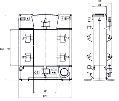

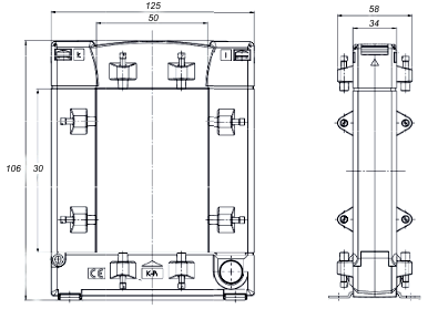

SCT4816-0018 dimensions, size 2
SCT4816-0018 | Split-core current transformer, differential current type A, 18 A AC, size 3 1:Fig.23: SCT4816-0018 dimensions, all dimensions in mm
