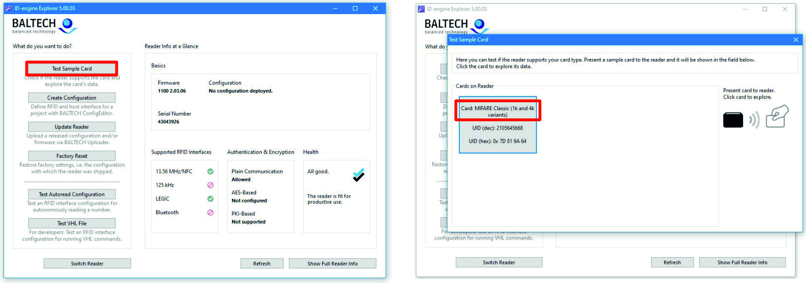

You can use the Baltech Tool Suite to configure your RFID reader and activate the chip card technology. If the chip card technology is still unknown before configuration, follow the steps below to familiarize yourself with the chip card technology:
1. Open the Baltech id-engine explorer program.
2. Click on Test Sample Card.
The chip card technology (MIFARE Classic here) is now known.
Configuration 1:Fig.8: Baltech id-engine explorer

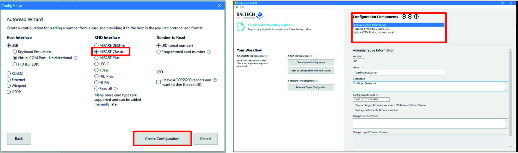

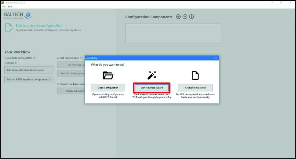

1. Start the Config Editor software.
2. Click on Start Autoread Wizard.
Configuration 2:Fig.9: Config Editor
3. Now choose the configuration criteria shown in Table 6 Interface (Host Interface), Chip card technology (RFID Interface) and Card area (Number to Read).
4. Click on Create Configuration.
The configuration is generated. An overview window for your configuration opens.
Configuration 3:Fig.10: Generate configuration
In the overview window, you can click on individual components of the generated configuration and customize them. You can also test and release the configuration (see below).
