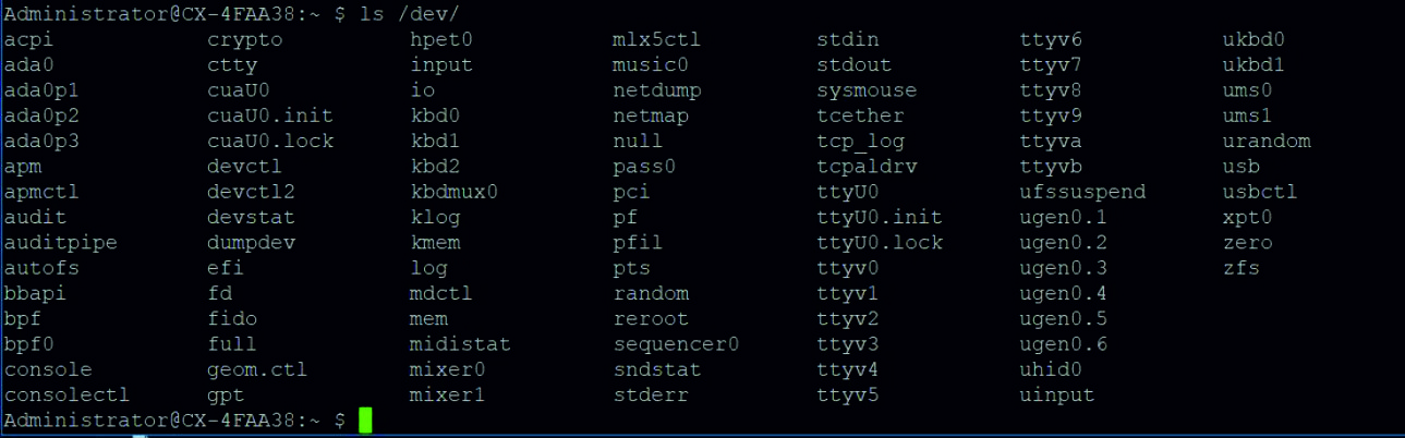

You can use the command "ls /dev/" to display all devices connected to your PC (see Fig. 5). This also includes the RFID reader. By default, this is recognized as virtual COM port ttyU0 and can be addressed via it. You can also use this port to address the RFID reader via TwinCAT.
Test and operation in TC/BSD 1:
Fig.5: TC/BSD connected devices
