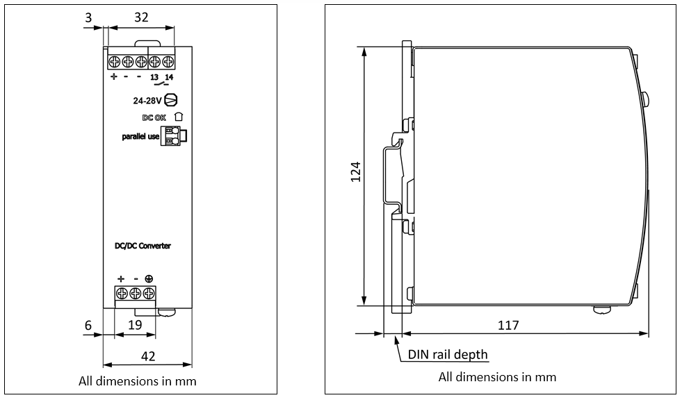

Dimensions and weight
Dimensions and weight | |
Overall width | 42mm |
Height | 124mm |
Depth | 117mm |
DIN rail | Use 35 mm DIN rails according to EN 60715 or EN 50022 with a height of 7.5 or 15mm. |
Weight | 520 g |
Housing material | Body: Aluminum alloy |
Installation clearances | See chapter on Safety instructions and installation requirements |
Penetration protection | Small parts like screws, nuts, etc. with a diameter larger than 3.5mm |
