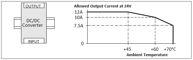

Mounting orientations 1:
Fig.23: Mounting position A (standard mounting position)

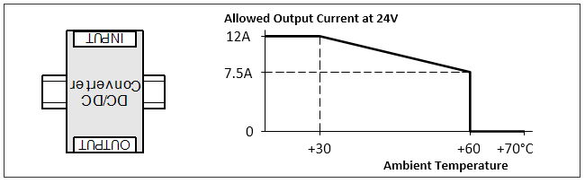

Mounting orientations 2:
Fig.24: Mounting position B (upside down)

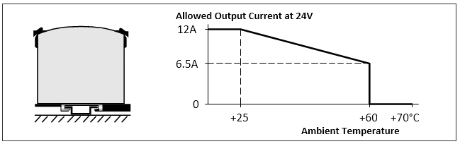

Mounting orientations 3:
Fig.25: Mounting position C (table-top mounting)

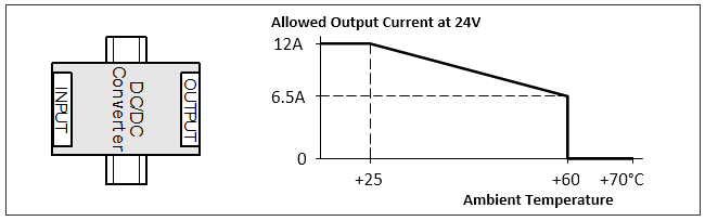

Mounting orientations 4:
Fig.26: Mounting position D (horizontal clockwise)

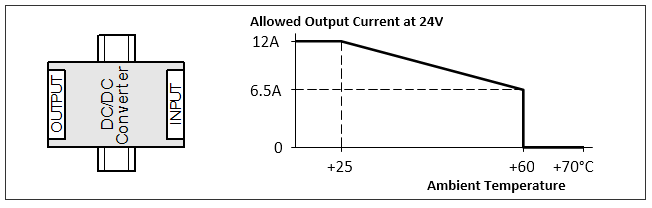

Mounting orientations 5:
Fig.27: Mounting position E (horizontal counterclockwise)
