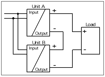

Series operation
Devices of the same type PS9711-2410-0000 can be connected in series for higher output voltages. It is possible to connect as many units in series as needed, providing the sum of the output voltage does not exceed 150Vdc. Voltages with a potential above 60Vdc must be installed with a protection against touching.
Avoid return voltage (e.g. from a decelerating motor or battery) which is applied to the output terminals.
Keep an installation clearance of 15mm (left / right) between two power supplies and avoid installing the power supplies on top of each other. Do not use power supplies in series in mounting orientations other than the standard mounting orientation.
Pay attention that EMI and inrush current will increase when using multiple devices.
