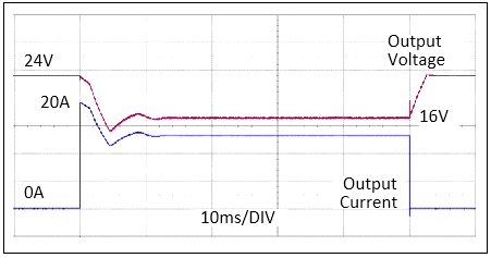

Peak current capability 1:
Fig.17: Peak load 20 A (resistive load) for 50 ms; Output voltage dips from 24 V to 16 V

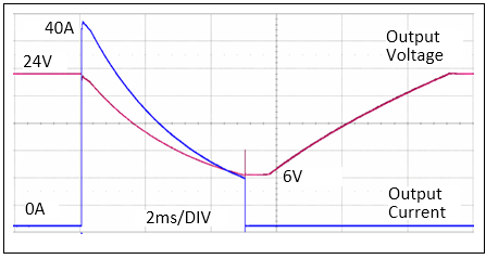

Peak current capability 2:
Fig.18: Peak load 40 A (resistive load) for 5 ms; Output voltage dips from 24 V to 6 V

Typ. from 24 V to 16 V
at 20 A for 50 ms, resistive load

Typ. from 24 V to 6 V
at 40 A for 5 ms, resistive load
