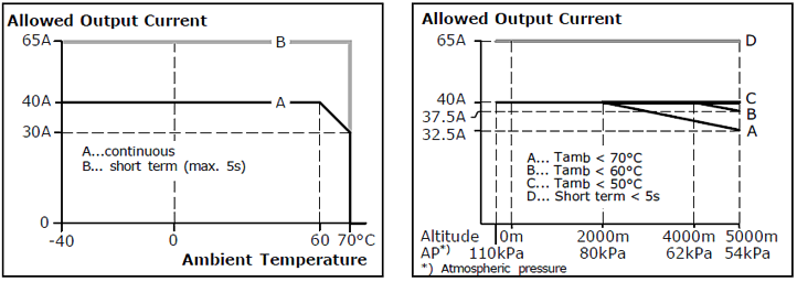

Operating temperature | -40 °C to + 70 °C | The operating temperature corresponds to the ambient or environmental temperature and is defined as the air temperature 2 cm below the device. |
Storage temperature | -40 °C to + 85 °C | For storage and transport |
Output load reduction | 1.0A/°C | Between +60 °C and +70 °C |
2.5A/1000m or 5°C/1000m | For altitudes >2000m, see Fig. Output current over installation altitude | |
The derating is not hardware-controlled. The user must take this into account in order to stay below the reduced current limits, so that device overload is avoided. | ||
