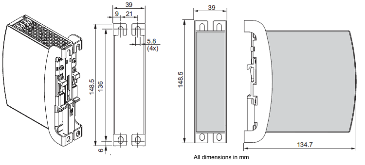

ZS5301-0002 – Bracket for wall mounting
This bracket is used to mount the devices to a wall or panel without using a DIN rail.
Accessories 1:
Isometric view, dimensions

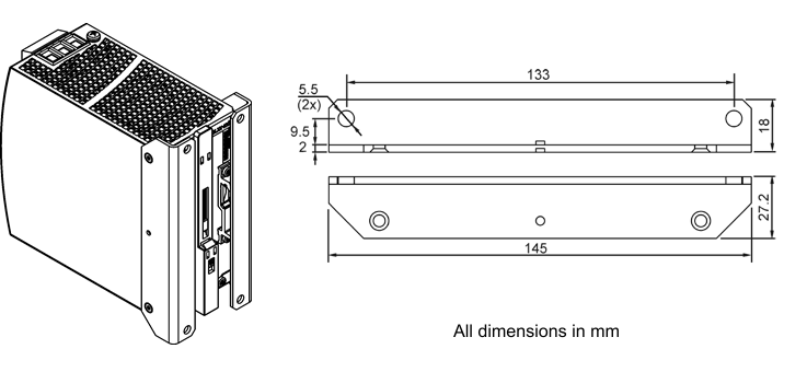

ZS5301-0003 – Bracket for wall mounting
This bracket is used to mount the device on a level surface or panel without the use of a DIN rail. The bracket can be mounted without loosening the DIN rail brackets.
Accessories 2:
Isometric view, installation dimensions of bracket for wall mounting

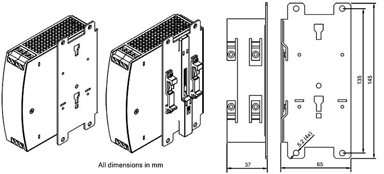

ZS5301-0004 – bracket for lateral mounting
This bracket is used in order to mount the devices laterally with or without the use of a DIN rail.
The two aluminum brackets and the black plastic slider of the unit must be removed to allow the steel brackets to be mounted.
For lateral DIN rail mounting, the previously removed aluminum brackets and the black plastic slider must be mounted on the steel bracket.
Accessories 3:
Isometric view, lateral mounting without and with DIN rail bracket; mounting dimensions
