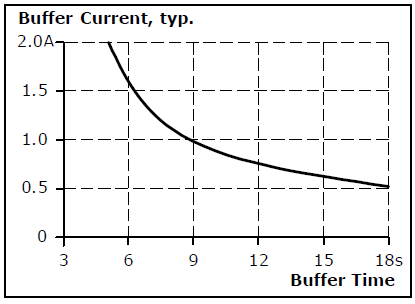

Buffer storage time
The buffer time (sometimes also called autonomy time) is the maximum timespan over which the capacitor can maintain the required output current. The buffer time mainly depends on the output current in buffer operation.
Any number of buffer modules can be connected in parallel in order to increase the buffer time.
Buffer time | Min. | 160 ms | At 22.5 V, 40 A |
Min. | 320 ms | At 22.5 V, 20 A | |
Typ. | 250 ms | At 22.5 V, 40 A | |
Typ. | 500 ms | At 22.5 V, 20 A | |
Typ. | 62 s | At 22.5 V, 0.1 A |
