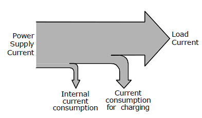

| Current consumption | Typ. | 80 mA | When the capacitor is fully charged |
| Min. | 400 mA | During the charging of the capacitors | |
| Max. | 600 mA | During the charging of the capacitors | |
| Power loss | Typ. | 1.9 W | When the capacitor is fully charged |

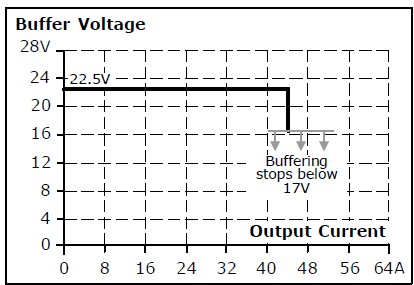

| Buffer current | Min. | 40 A |
| Buffer current overload behavior |
 | Electronically limited, buffering stops and capacitor is discharged under 17 V.  | |
