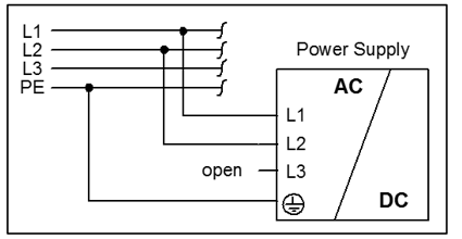

Operation on two phases of a 3-phase system
No external protective devices are required to protect against phase failure.
This power supply can also be operated continuously on two strings of a 3-phase system. However, it is not recommended for this performance class, since the feeding 3-phase network can become unbalanced.

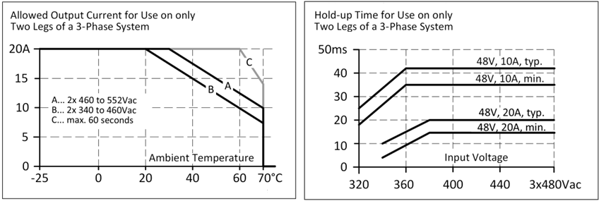

- When operating on only two strings of a three-phase system, the output power must be reduced according to the curves below. Exceedance of these limit values over extended periods leads to thermal shutdown of the system.
- Operation below 340 Vac with an output current of more than 15 A can also cause a thermal shutdown.
- When switching on, there may be some start-up attempts until the output power is fully available.
- EMI behavior, hold-up time, losses and output ripple are different from three-phase operation. Therefore check the suitability for your individual application.
- The screw of the unused terminal must be firmly tightened.
