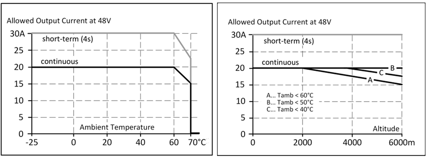

Operating temperature 1) | -25°C to +70°C | Reduction of the output power according to Fig. Output current over ambient temperature |

Installation altitude | 0 to 2000 m | Without restrictions |
2000 - 6000 m | Reduce the output power or the ambient temperature, see Fig. Output current over installation altitude IEC 62103, EN 50178, overvoltage category II | |
Derating, installation altitude | 60 W/1000 m or 5°C/1000 m | > 2000 m, see Fig. Output current over installation altitude |
