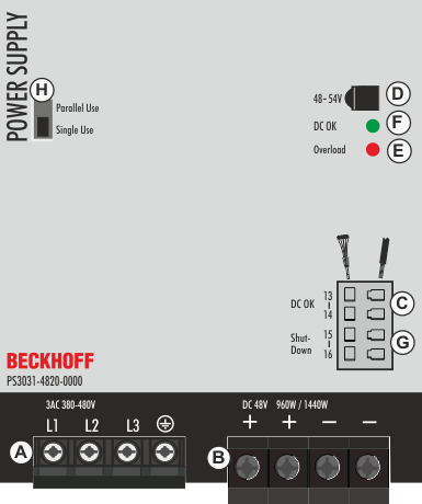

Front side and operating elements
Front side and operating elements 1:
PS3031-4820-0000, front
Input terminals (screw terminals)
Designation (A)
L1, L2, L3
Mains input L1, L2, L3
Front side and operating elements 2:
PE input (protective conductor)
Output terminals (screw terminals, two contact pins per pole)
Designation (B)
two identical positive poles, positive output
two identical negative poles, negative output
DC-OK relay contact (spring-loaded terminals)
Designation (C)
13 / 14 make contact
The DC-OK relay contact is synchronized with the DC-OK LED
See chapter on DC OK relay contact for more information.
Potentiometer for the output voltage
Designation (D)
Potentiometer cover
Open the flap to adjust the output voltage.
Factory setting: 48.0 V at rated output current, "Single Use" mode
Overload LED
Designation (E)
LED red
On when the voltage at the output terminals is <90% of the set output voltage, or in the event of a short circuit in the output.
Flashes when the switch-off has been activated or when the device has switched off due to overtemperature.
The input voltage is always required.
DC-OK LED
Designation (F)
LED green
On when the voltage at the output terminals is >90% of the set output voltage.
Shutdown input
Designation (G)
Shutdown input
Input for shutdown and remote control
Enables the power supply to be switched off. Can be activated by a switch contact or external voltage. The remote control input allows the output voltage to be set. For details see chapters DC-OK relay contact and Shutdown input
Selector switch for "Parallel Use" / "Single Use" mode
Designation (H)
Set the jumper to "Parallel Use" mode if power supplies are connected in parallel to increase the output power. In order to distribute the load current between the individual power supplies, "Parallel Use" mode regulates the output voltage so that the idle voltage is approx. 4% higher than at nominal load. See also chapter "Parallel Use" for power increase. A missing jumper corresponds to "Single Use" mode.
LED displays
Overload LED
DC-OK LED
DC-OK contact
Normal mode
OFF
ON
Closed
During extra power
OFF
ON
Closed
Overload (Vout < 90%)
ON
OFF
Open
Short circuit at output
ON
OFF
Open
Temperature switch-off
flashes
OFF
Open
Shutdown input active
flashes
OFF
Open
No input power
OFF
OFF
Open
