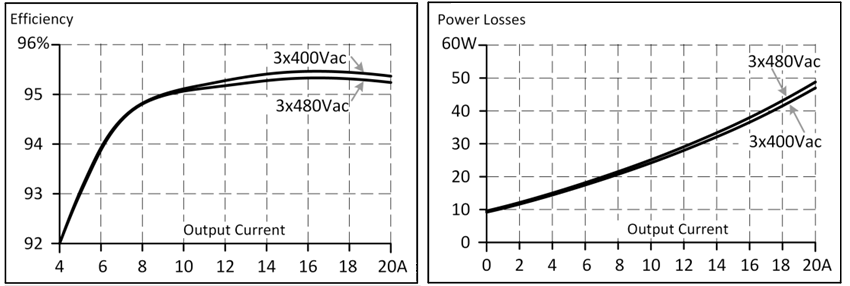

Efficiency and losses 1:
Efficiency over output current; losses over output current

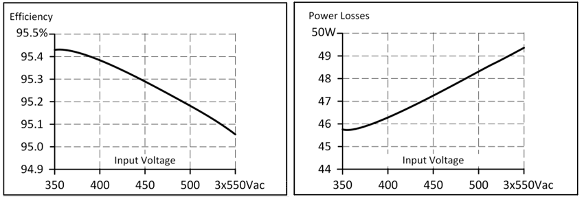

Efficiency and losses 2:
Efficiency over input voltage; losses over input voltage

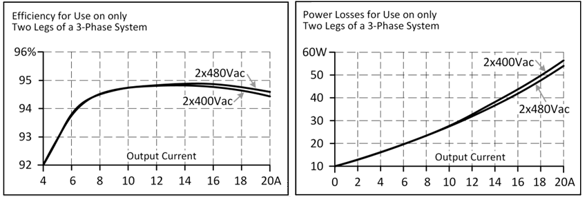

Efficiency when using only two phases of a 3-phase system:

Efficiency and losses 3:
Operation on two phases of a 3-phase system

Efficiency and losses 4:
Efficiency over output current at 48 V; losses over output current at 48 V
