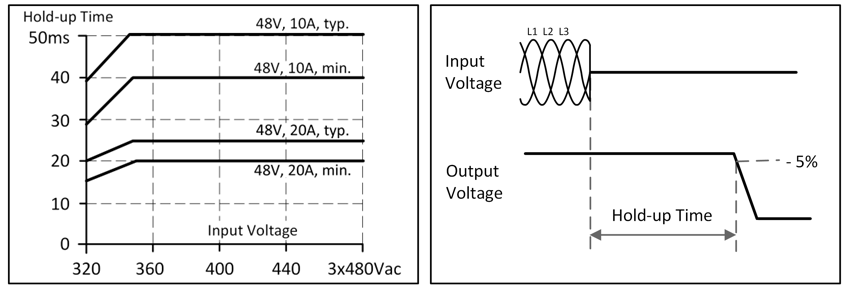

Hold-up time
| 3AC 400 V1) | 3AC 480 V1) |
Hold-up time | Typ. | 50 ms | 50 ms | At 48 V, 10 A, see Fig. Hold-up time over input voltage |
Min. | 40 ms | 40 ms | At 48 V, 10 A, see Fig. Hold-up time over input voltage | |
Typ. | 25 ms | 25 ms | At 48 V, 20 A, see Fig. Hold-up time over input voltage | |
Min. | 20 ms | 20 ms | At 48 V, 20 A, see Fig. Hold-up time over input voltage |
1) Characteristic curves and figures for operation on only two external conductors of a 3-phase system can be found in chapter Operation on two phases of a 3-phase system.
