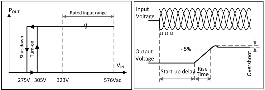

Turn-on voltage
Typ.
3x 305 Vac
Static, load-independent, see Fig. Input voltage range; switch-on behavior definitions
Shut-down voltage
Typ.
3x 275 Vac

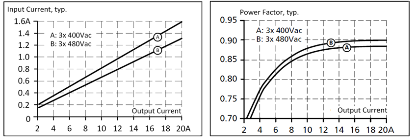

Input current
Typ.
1.65 A
1.35 A
At 48 V, 20 A per phase, see Fig. Input current over output current; power factor over output current
Power factor*)
Typ.
0.88
0.90
At 48 V, 20 A, see Fig. Input current over output current; power factor over output current
Start-up delay
Typ.
500 ms
600 ms
See Fig. Input voltage range; switch-on behavior definitions
Rise time
Typ.
23 ms
23 ms
At 48 V, 20 A, ohmic load only, 0 mF, see Fig. Input voltage range; switch-on behavior definitions
Typ.
47 ms
47 ms
At 48 V, 20 A ohmic load with an additional 20 mF capacitor, see Fig. Input voltage range; switch-on behavior definitions
Turn-on overshoot
Max.
1 V
1 V
*) The power factor is the ratio of real (or active) power to apparent power in an AC circuit.
