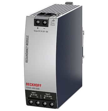

PS9421-4840-0000– Redundancy Module
Redundancy and buffer modules 1:
The PS9421-4840-0000 is a redundancy module that can be used for the construction of 1+1 and N+1 redundancy systems.
It has two input channels, to which power supplies with output currents of up to 20 A can be connected, and one output that can carry nominal currents of up to 40 A.
The redundancy module uses MOSFET technology instead of diodes for decoupling the two input channels. This reduces the heat development and the voltage drop between input and output. Due to the low power loss, the device is very narrow and requires a width of just 46 mm on the DIN rail.
Large connection terminals enable secure and fast installation.
The redundancy module requires no additional auxiliary voltage.
Due to the international approvals package, the device is suitable for virtually every application.
Observe the connection instructions in the chapter "Parallel use for redundancy”

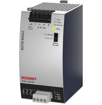

PS9031-4820-0001– Buffer Module
Redundancy and buffer modules 2:
The PS9031-4820-0001 buffer module is an additional device for 48 V DC power supply units. It supplies power to bridge typical mains power failures or extends the hold-up time after switching off the AC voltage.
If the power supply unit supplies sufficient voltage, the buffer module stores energy in the integrated electrolytic capacitors. In the event of a failure of the mains voltage, the stored energy is supplied to the DC bus in a controlled process.
The buffer module can be connected at any point in parallel with the load circuit and does not require any control wiring.
A buffer module can provide 20 A of additional power and can be added in parallel to increase the output current or hold-up time.
