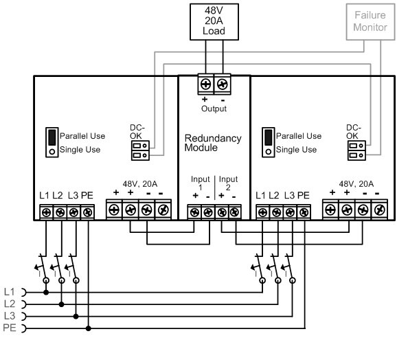

Wiring example:
1+1 Redundancy 2:
Wiring for 1+1 redundancy with a PS9421-4840-0000 redundancy module
