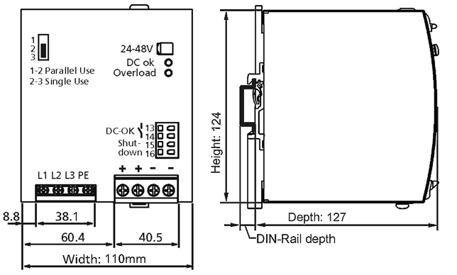

Dimensions and weight
Dimensions and weight | |
Overall width | 110 mm |
Height | 124 mm |
Depth | 127 mm |
Weight | 1500 g |
DIN rail | Use 35 mm DIN rails according to EN 60715 or EN 50022 with a height of 7.5 or 15 mm. |
Housing material | Housing: Aluminum alloy Cover: Steel |
Installation clearances | See chapter on Safety instructions and installation requirements |
