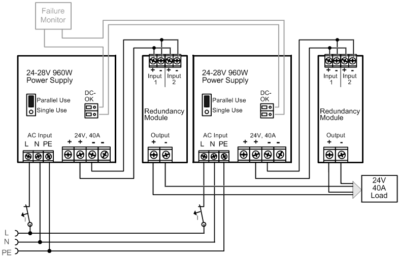

Wiring example:
Parallel use for redundancy 2:
1+1 redundancy for 40 A with two PS9401-2440-0000 dual redundancy modules and two power supplies
