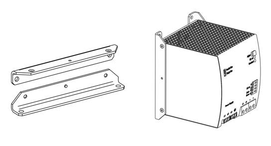

ZS5301-0002 – Bracket for wall mounting
This bracket is used to mount the devices to a wall or panel without using a DIN rail.
Mounting accessories 1:
ZS5301-0002, isometric view

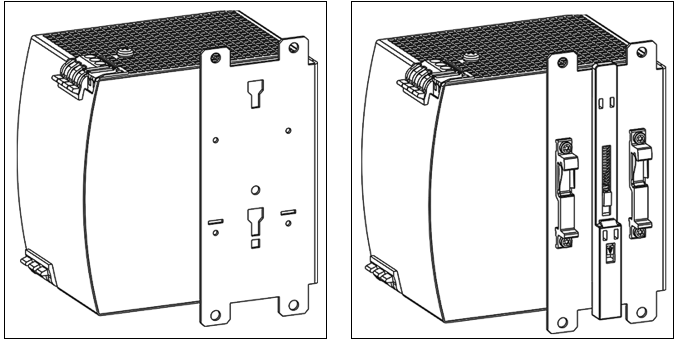

ZS5301-0008 – Bracket for side mounting
This bracket is used to mount the PS3xxx power supply laterally with or without a DIN rail.
The two aluminum brackets and the black plastic slider of the unit must be removed to allow the steel brackets to be mounted.
For lateral DIN rail mounting, the previously removed aluminum brackets and the black plastic slider must be mounted on the steel bracket.
Mounting accessories 2:
Lateral mounting with and without DIN rail brackets
