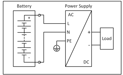

Instructions for DC operation
- Use a battery or a comparable DC source. For other sources, please contact Beckhoff Support.
- Connect the positive pole to L and the negative pole to N.
- Connect the PE terminal to the protective conductor or machine ground.
