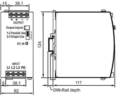

Dimensions and weight
Dimensions and weight | |
Overall width | 62mm |
Height | 124mm |
Depth | 127mm |
Weight
| 750 g |
DIN rail
| Use 35 mm DIN rails according to EN 60715 or EN 50022 with a height of 7.5 or 15mm. |
Housing material | Housing: Aluminum alloy Cover: Galvanized steel |
Ingress protection | Small parts such as screws, nuts, etc. with a diameter greater than 3.5 mm |
Installation clearances | See chapter on Safety instructions and installation requirements |
