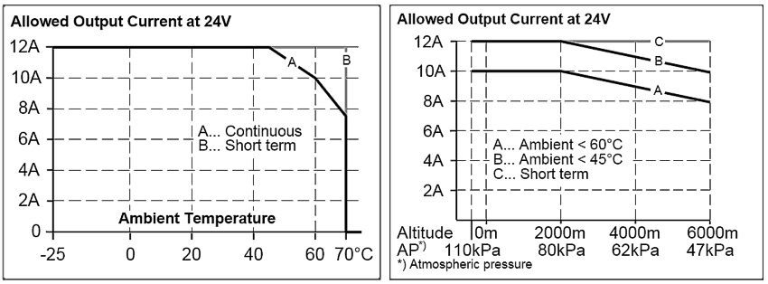

Reduction of the output power according to Fig. Output current over ambient temperature

15W/1000m or 5°C/1000m
For altitudes >2000m, see Fig. Output current over installation altitude
9W/-5kPa or 3°C/-5kPa
For atmospheric pressures <80kPa, see Fig. Output current over installation altitude

Environment 1:
Output current over ambient temperature; output current over installation altitude
