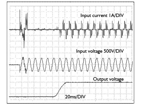

Input inrush current
Active inrush current limitation limits the inrush current surge after the input voltage is switched on.
The charge current of the interference suppression capacitors during the first few microseconds after switching on is not taken into account.
| 3AC 400V | 3AC 480V |
Input inrush current | Max. | 10Apeak | 10Apeak | temperature-independent
Typ. | 4Apeak | 4Apeak | ||
Inrush energy | Max. | 0.5A²s | 0.5A²s |
