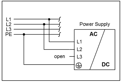

Operation on two phases
No external protective device is required to protect against phase failure.

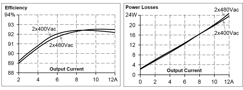

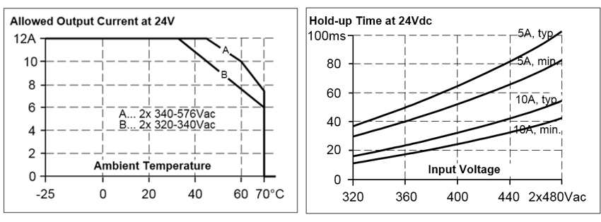

The power supply may only be operated continuously on two strands of a three-phase system if the output power is reduced according to the curves shown below. Exceedance of these limit values over extended periods leads to thermal shutdown of the device.
Make sure the EMC performance, Hold-up time and losses are different from three-phase operation. Therefore check the suitability of your individual application.
