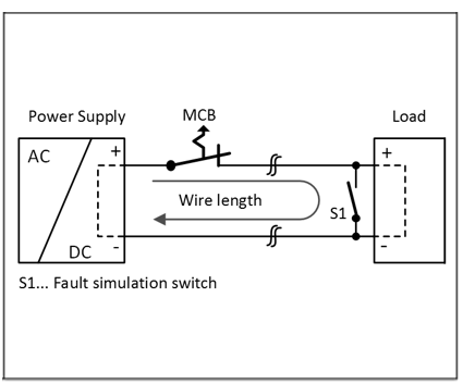

The following table contains typical test results that show which circuit breakers with B and C characteristics trip magnetically, depending on the wire cross-section and the wire length.
Maximum wire length*) for fast (magnetic) tripping:

*) Don't forget to double the distance to the load (or the cable length) when calculating the total cable length (plus and minus cable).
